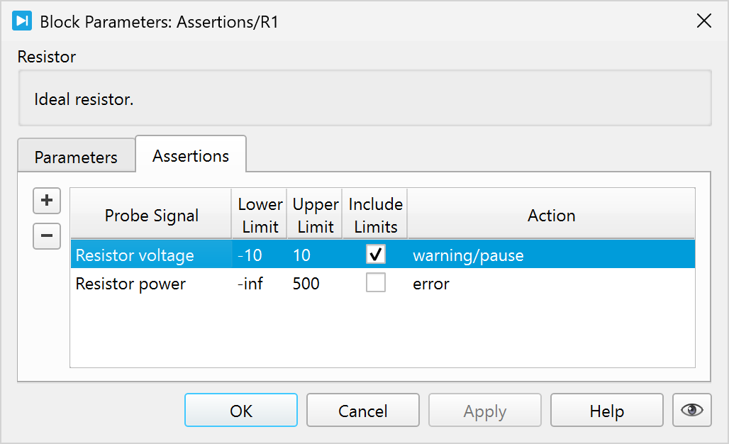

PLECS also provides the possibility to add assertions directly to components. This can be used to define a valid range for any probe signal of a component. To add assertions to a component, open its parameter dialog and click on the Assertions tab. If the parameter dialog of a component does not provide this tab, it is not possible to add assertions.
../../_images/assertionstab.png
Use the “+” and “-” buttons to add or remove assertions. In the different columns, the parameters for the assertions can be provided: the probe signal that is limited by the assertion, the lower and upper limits, whether the limits should be inclusive, and the action executed when the assertion fails (see above). If the limits are included (by setting a check mark in that column), the limits themselves are considered part of the valid range, otherwise the signal has to be strictly within the limits. The values -inf and inf may be used to disable the lower or upper limit, respectively.
