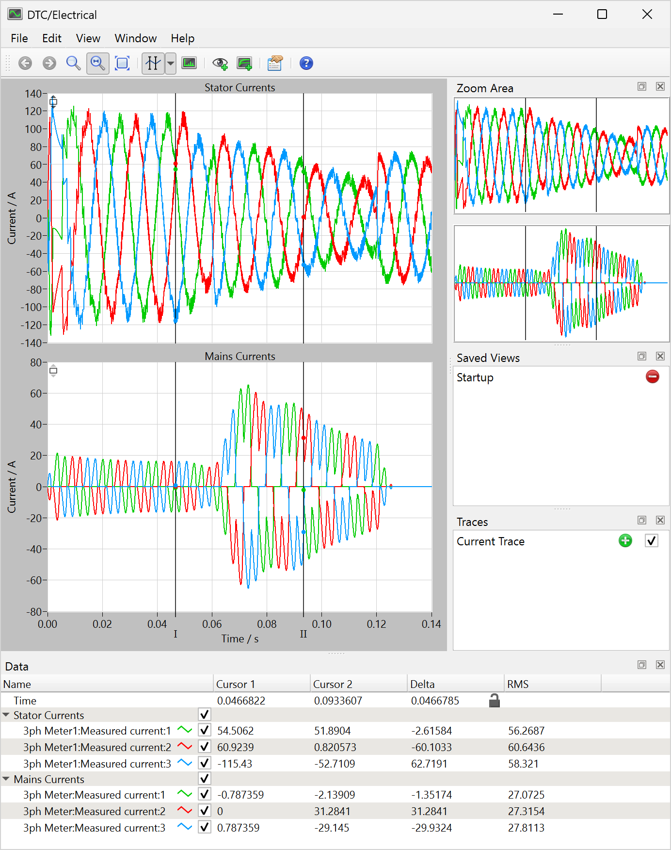

The PLECS scope is used to display simulation results and offers powerful zooming and analysis tools to simplify viewing and processing results. The Scope block can be placed on the Simulink worksheet or in the PLECS circuit. The appearance of the PLECS scope is depicted in Fig. 47. The scope contains a plot area and optional Zoom Area, Saved Views, Traces and Data windows.

Double clicking on the Scope block opens the Scope window. The main window of the scope can contain multiple plots. Plots can be quickly added or removed by right clicking the plot area and selecting Insert plot above, Insert plot below or Remove plot from the context menu.
The optional Zoom Area, Saved Views, Traces and Data windows can be opened by right-clicking on the toolbar area. They can also be opened from the View menu. These optional windows can be docked and undocked from the main window. To dock them in main window, simply drag them to the desired location inside the main window.
