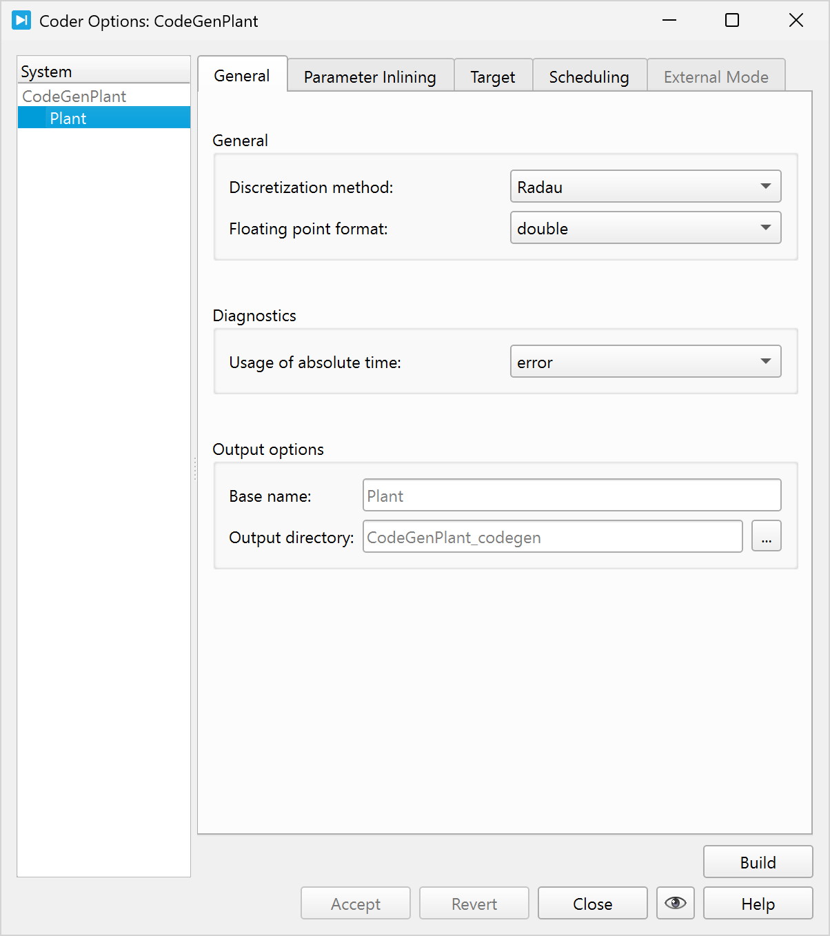

Generating Code
To generate code, choose Coder options… from the Coder menu. This menu only appears if you have a license for the PLECS Coder.
Fig. 121 Coder Options dialog window
The left hand side of the dialog window shows a tree view of the model and the code-generation subsystem that it contains. Intermediate subsystems that have not been enabled for code generation appear as disabled entries that cannot be selected.
- Code Generation subsystems
To enable a subsystem for code generation, select the subsystem, then choose Execution settings… from the Edit > Subsystem menu or the block’s context menu. In the Subsystem Settings dialog check the option Enable code generation. Alternatively, use the dedicated Code Genereation Subsystem component from the PLECS component library.
Note that it is not possible to enable code generation for a subsystem that is contained by or that itself contains other subsystems that enable code generation. Checking this option implicitly also checks the option Treat as atomic unit and unchecks the option Minimize occurrence of algebraic loops. For more information on these options see Virtual and Atomic Subsystems.
The right hand side of the dialog window shows a tabbed dialog with the code generation options for the system that is selected in the tree view. To generate code for the currently selected system, click on the Build button at the bottom of the right hand side.
Code generation can also be initiated in an Octave simulation script or via the RPC interface using the commands
plecs('codegen', 'path', optStruct, 'outputDir')
or
plecs.codegen('path', optStruct, 'outputDir')
respectively, where path is a model name or a subsystem path. The parameters optStruct and outputDir are optional.
If optStruct is provided, it is expected to be a struct as described in Scripted Simulation and Analysis Options. This enables you e.g. to generate code for different parameter values without having to modify the model file.
If outputDir is provided, the generated files will be placed in this folder instead of the folder that is specified in the model.
General
- Discretization method
This parameter specifies the algorithm used to discretize the physical model equations (see Physical Model Discretization).
- Floating point format
This parameter specifies the default data type (
floatordouble) that is used for floating point variables in the generated code.- Usage of absolute time
This setting allows you to specify the diagnostic action to be taken if PLECS generates code for a component that depends on the absolute time. In order to minimize round-off errors, PLECS generates code to calculate the absolute time using a signed 64-bit integer tick counter. If a simulation runs for an infinite time, this tick counter will eventually reach its maximum value, where it is halted to avoid problems that might occur if the counter was wrapped to the (negative) minimum value, such as a Step block resetting to its initial value. To put things into perspective, assuming a step size of \(1\,\mu\mathrm{s}\), this would occur after \(292{,}271\) years.
Depending on this setting, PLECS will either ignore this condition or it will issue a warning or error message that indicates the components that use the absolute time.
- Base name
This parameter allows you to specify a custom prefix used to name the generated files and the exported symbols such as the interface functions or the input, output and parameter structs. By default, i.e. if you clear this field, the base name is derived from the model or subsystem name.
- Output directory
This parameter allows you to specify, where the generated files are stored. This can be an absolute path or a relative path with respect to the location of the model file. The default path is a directory
model_codegennext to the model file.
