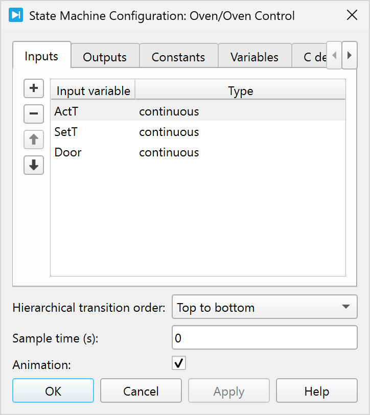

State Machine Configuration
To open the configuration editor, click on the property-blue button in the tool bar.
../_images/fsm_configuration.png
Fig. 113 State machine configuration editor
Input Signals
On the Inputs tab you define input signals that are fed from the surrounding system into the state machine. Input signals are specified by an Input variable and a Type.
The Input variable specifies the name with which you refer to the input signal in actions or expressions. It is also displayed next to the corresponding input terminal of the State Machine block. The variable name must be unique and a valid C identifier, i.e. it must start with a letter and consist of only letters, numbers and underscores.
The Type specifies whether the signal is a continuous signal or a trigger signal. For continuous and trigger signals, the actual signal value is assigned to the input variable in every time step. For trigger signals, additionally an event with the same name will be created when the input signal changes in the prescribed way. A rising trigger event is created in the instant when the input signal changes from zero to non-zero, a falling trigger event is created in the instant when the input signal changes from non-zero to zero. For trigger signals, a trigger symbol is also displayed next to the corresponding input terminal of the State Machine block.
Signal changes from one non-zero value to another non-zero value, e.g. from a negative value to a positive value, do not cause an event to be created.
Input signals appear on the State Machine block in the order in which they appear in the list. Use the four buttons to the left of the list to add or remove inputs or to change their order.

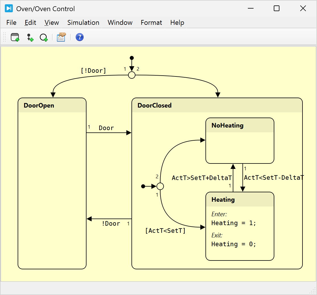

Oven Control
This example demonstrates a simple oven control. While the oven is in operation, a hysteresis type control shall keep the oven temperature within a certain tolerance band around a set point by switching the heating on and off. As a safety measure, we also want to ensure that the heating is always switched off when the oven door is open.
Example Model
  • See the example model “Oven Control”.
  • Find it in PLECS under Help > PLECS Documentation > List of Example Models.
../_images/ovencontrol.svg
Fig. 117 Example of a simple oven control
The oven is modeled with a heat source, a thermal capacitance and resistance and a thermometer. The oven control is implemented with a state machine. Its inputs are the actual and the desired temperature and the status of the oven door, which is defined as 0 when the door is open and 1 when the door is closed. The state machine output is the command for the oven heating. The state machine uses a constant variable DeltaT that determines the limits of the tolerance band around the desired temperature.
The top-level states DoorOpen and DoorClosed reflect the actual state of the oven door. The default transition, which is taken at the first execution of the state machine, is branched with a Junction. If the door is initially open, the (i.e. Door==0), DoorOpen state will be entered, else the DoorClosed state. Notice that the unconditional “else” branch leaving the Junction has a lower precedence than the conditional branch. Afterwards, the state machine will transition from DoorOpen to DoorClosed when Door becomes non-zero and vice versa when the input variable Door becomes zero.
DoorClosed is a compound state. Therefore, when it is the target of a transition, its internal default transition will be executed, which is also branched with a Junction. If the actual temperature is below the set point when the default transition executes, the Heating state will be entered, else the NoHeating state. Afterwards, the state machine will transition from Heating to NoHeating when the actual temperature becomes greater than the upper limit and from NoHeating to Heating, when the actual temperature becomes less than the lower limit.
The output variable Heating is set to 1 when the Heating state is entered, and to 0 when the state is left. Notice that it does not matter whether the state is left because the transition ActT>SetT+DeltaT is taken when the temperature exceeds the upper limit, or because the transition !Door is taken when the oven door is opened. In either case, the Exit action of Heating is executed and the heating is turned off.
For this state machine to work properly, the Hierarchical Transition Order must be set to top to bottom (which is the default). This is important because a door opening event might coincide with the event that the actual temperature exceeds the upper or lower limit. The higher-level door opening event must take precedence over the lower-level temperature events so that the state machine will unconditionally transition to the DoorOpen state.
