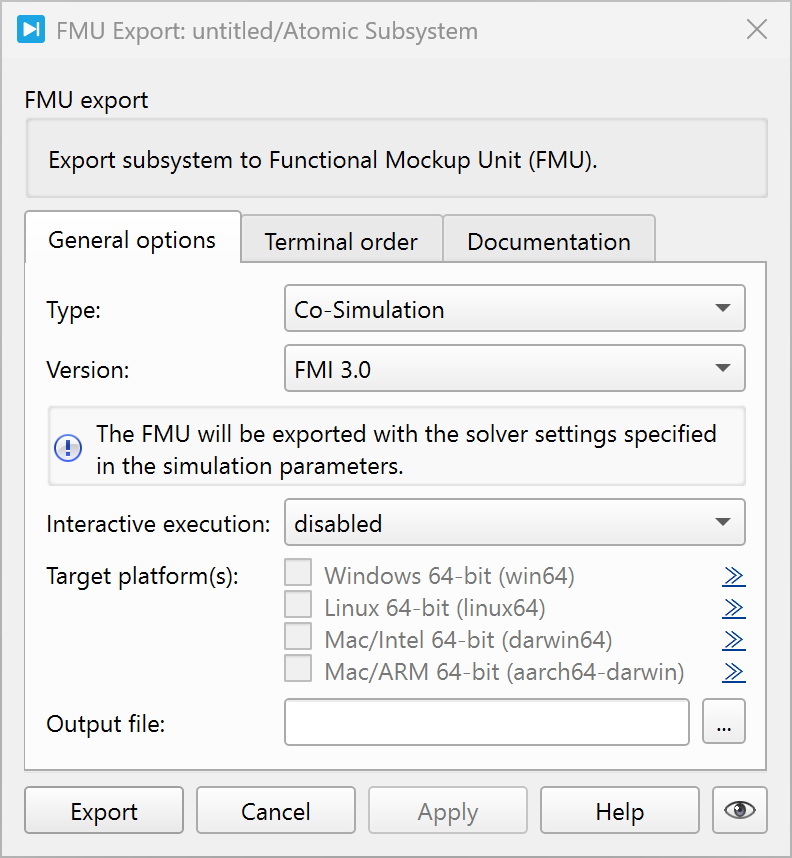

To export an atomic subsystem to an FMU, select the Subsystem block, then choose Export FMU… from the Edit > Subsystem menu or the block’s context menu. This will open the FMU Export dialog that allows you to configure the FMU as described below. When you click on Export, the FMU is created.
General Options
../_images/fmuexport_general.png
Fig. 122 General Options tab of FMU Export dialog
Type
This parameter lets you choose between the Co-Simulation and Model Exchange types.
Version
This parameter lets you choose between the FMI standard versions 2.0 and 3.0. Note that the importing tool must support the same version in order to use the FMU.
Sample time
This parameter is applicable only to Model Exchange FMUs. It specifies the sample time used to discretize the exported subsystem. It is recommended to run a simulation with a fixed-step solver using this sample time before the export to verify the proper behavior of the discretized model.
Interactive execution
This parameter is applicable only to Co-Simulation FMUs. If this is set to enabled and the importing tool supports it, PLECS will open the schematic of the FMU model at runtime and allow the importer to interact e.g. with scopes.
Target platform(s)
These checkboxes let you choose the binary platform(s) on which you intend to run the exported FMU. PLECS will embed the corresponding shared libraries into the FMU.
Before you can export an FMU for the first time, you need to install the shared library files on your computer. This is indicated by blue arrows next to the checkbox items as shown below. When you click on any of them, a dialog opens that lets you download and install the required package automatically.
Output file
This parameter specifies the file path of the exported FMU.

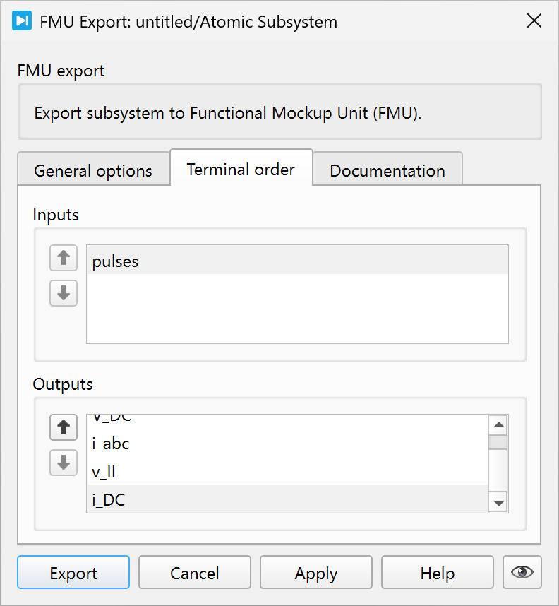

Terminal Order
../_images/fmuexport_terminals.png
Fig. 123 Terminal Order tab of FMU Export dialog
On this page you can configure the order in which the input and output terminals of the subsystem appear in the exported FMU.

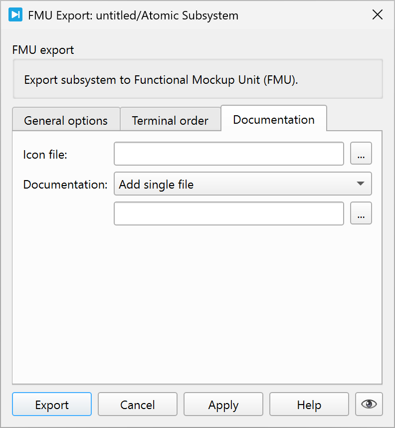

Documentation
../_images/fmuexport_documentation.png
Fig. 124 Documentation tab of FMU Export dialog
Icon file
This parameter allows you to specify a PNG image file that is included as a model icon in the exported FMU.
Documentation
This parameter allows you to provide documentation that is included in the exported FMU. You can choose to include a single HTML file or a folder with HTML and resource files.
