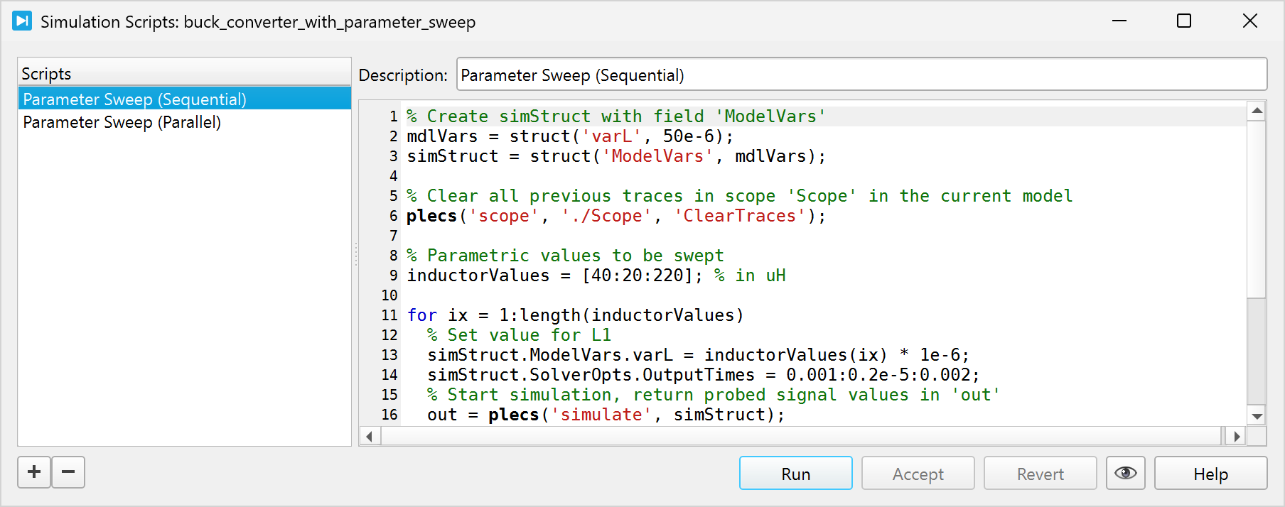

Simulation scripts are managed in the Simulation Scripts dialog shown in Fig. 118. To open the dialog, select Simulation scripts… from the Simulation menu of the schematic editor.
../_images/SimulationScriptDlg.png
Fig. 118 Simulation Scripts dialog in PLECS Standalone
The left hand side of the dialog window shows a list of the scripts that are currently configured for the model. To add a new script, click the button marked + below the list. To remove the currently selected script, click on the button marked -. You can reorder the scripts by clicking and dragging an entry up and down in the list.
The right hand side of the dialog window shows the script in an editor window. Each script must have a unique Description.
The button Run/Stop starts the currently selected script or aborts the script that is currently running.
To make changes to the script without running it, press the Accept button. The Revert button takes back any changes that have been made after the Accept or Run button was pressed.
PLECS Standalone uses GNU Octave to execute simulation scripts. The Octave language is very similar to MATLAB. A full syntax description of the Octave scripting language is available in the Octave documentation.
↳ Changed in PLECS 4.4: Updated to Octave 4.4.
Any console output generated by Octave will appear in the Octave Console window, which you can open by choosing Show Console from the Window menu.

Example Script
The following script runs a parameter sweep by setting the variable varL to the values in inductorValues. It is used in the demo model BuckParamSweep.
mdlVars = struct('varL', 50e-6);
opts = struct('ModelVars', mdlVars);
plecs('scope', './Scope', 'ClearTraces');
inductorValues = [50, 100, 200];
for ix = 1:length(inductorValues)
  opts.ModelVars.varL=inductorValues(ix) * 1e-6;
  out = plecs('simulate', opts);
  plecs('scope', './Scope', 'HoldTrace', ...
        ['L=' mat2str(inductorValues(ix)) 'uH']);
  [maxv, maxidx] = max(out.Values(1,:));
  printf('Max current for L=%duH: %f at %fs\n', ...
         inductorValues(ix), maxv, out.Time(maxidx));
end
The first two lines create a struct ModelVars with one field, varL. The struct is embedded into another struct named opts, which will be used later to initialize the simulation parameters.
Inside the for-loop each value of inductorValues is assigned successively to the structure member variable varL. A new simulation is started, the result is saved in variable out for post-processing. By holding the trace in the scope the scope output will remain visible when a new simulation is started; the scope path uses a dot to reference the current model (see Path Substitution). The name of the trace is the inductance value.
The script then searches for the peak current in the simulation results and outputs the value and the time, at which it occurred, in the Octave Console.
