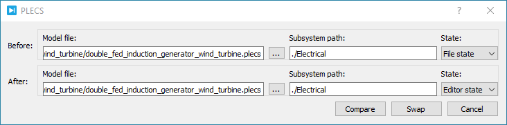

Computing a Diff in PLECS Standalone
The Diff tool can compare either two complete PLECS models or two subsystems contained in one or two PLECS models. To compute a Diff, choose the option Compare in the File menu. This opens the Diff dialog.
../_images/diff_dialog_standalone.png
Fig. 125 Standalone Diff dialog
This dialog has the two rows “Before” and “After” to specify the two entities that should be compared. You can use drag&drop to specify a model or a subsystem for comparison. Each row in the Diff dialog contains the following fields:
Model file
This field is used to specify the path of the model file. Depending on the models that are currently open in PLECS, this field is already filled with a reasonable suggestion. You can also use drag&drop or the Open file browser button () to choose a file.
Subsystem path
This field can be used to specify a subsystem for the comparison. If you want to compare subsystems you have to specify a subsystem for both the “before” and “after” row. You cannot compare a model with a subsystem. The subsystem path should also contain the name of the model, which can be abbreviated by a dot (.). If you use only the model name or a dot or if you leave this field empty, the whole model will be compared. Depending on the subsystems that are currently selected in PLECS, this field is already filled with a reasonable suggestion. You can also drag&drop a subsystem from a schematic window.
State
This is a drop-down list that can specify either one of the values File state or Editor state. If you choose File state, the state the model has in the model file is used for comparison. If you choose Editor state, the unsaved changes of an open model are used for comparison. This can be useful to review changes before saving a model.
Differences are defined as editing steps from the “before” model to the “after” model. A component present in the “before” model but missing in the “after” model will be displayed as a deletion. If you decide that you would like the differences to be presented the other way around, use the Swap button to swap all fields in the “before” and “after” row.
Once you have filled out all fields, press the Compare button to start the Diff computation. A progress bar will show the current state of the Diff computation. If you want to abort the Diff computation, press Cancel. Once the Diff computation has finished, the Diff result window will show the result.

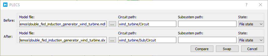

Computing a Diff in PLECS Blockset
The Diff tool can compare either two complete PLECS circuits contained in one or two Simulink models or two subsystems contained in one or two PLECS circuits. To compute a Diff, choose the option Compare in the File menu. This opens the Diff dialog.
../_images/diff_dialog_blockset.png
Fig. 126 Blockset Diff dialog
Model file
This field is used to specify the path of the Simulink model file. Depending on the models that are currently open, this field is already filled with a reasonable suggestion. You can also use drag&drop or the Open file browser button () to choose a file. Valid model file extensions are mdl and slx.
Circuit path
This field is used to specify the path of the PLECS Circuit within the Simulink model. It should start with the Simulink model name and end with the PLECS Circuit name. Depending on the models that are currently open, this field is already filled with a reasonable suggestion.
Subsystem path
This field can be used to specify a subsystem for the comparison. If you want to compare subsystems you have to specify a subsystem for both the “before” and “after” row. You cannot compare a circuit with a subsystem. The subsystem path should also contain the name of the circuit, which can be abbreviated by a dot (.). If you use only the circuit name or a dot or if you leave this field empty, the whole circuit will be compared. Depending on the subsystems that are currently selected in PLECS, this field is already filled with a reasonable suggestion. You can also drag&drop a subsystem from a schematic window.
State
This is a drop-down list that can specify either one of the values File state or Editor state. If you choose File state, the state the circuit has in the model file is used for comparison. If you choose Editor state, the unsaved changes of an open model are used for comparison. This can be useful to review changes before saving a model.
Differences are defined as editing steps from the “before” model to the “after” model. A component present in the “before” circuit but missing in the “after” circuit will be displayed as a deletion. If you decide that you would like the differences to be presented the other way around, use the Swap button to swap all fields in the “before” and “after” row.

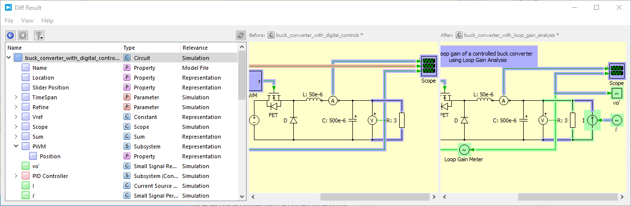

How to Interpret the Results
The result of computing a Diff is shown in the Diff result window. This window contains a Diff browser and two views, one for the “before” model and one for the “after” model.
../_images/diff_result_window.png
Fig. 127 Diff result window
The Diff Browser
The Diff browser can be used to navigate through the differences between the two models. It is similar to the Circuit Browser shown in schematic windows (see Circuit Browser). However, there are three important differences:
  1. The Diff browser shows not only components but also all other kinds of items stored in a model, e.g. parameters, properties like the positions of components, analyses and simulation scripts
  2. The Diff browser only shows the items that actually changed
  3. The Diff browser merges both models into one tree, i.e. an item in the tree represents the corresponding item in both models (if it exists)
There are cases where an item is located in different schematics in the “before” and “after” models. For example, if a resistor is in the root schematic in the “before” model and within a subsystem in the “after” model, it will appear twice in the Diff browser.

The Diff Views
To the right of the Diff browser, there are two views that show the currently selected item in the appropriate context, e.g., a changed component is shown in the parent schematic, a changed parameter is shown in the parameter dialog. Each view shows the path of the currently visible item at the top. By clicking on an element of the path, you can navigate to the corresponding item.
By default, the left view shows the “before” model and the right view shows the “after” model. You can swap the two views in the General tab of the PLECS preferences dialog (see Configuring PLECS). Note that swapping the views only changes their location in the window and has no influence on the roles of the “before” and “after” models.
As in the Diff browser, items deleted from the “before” model are marked in red, items inserted into the “after” model are marked in green and modified items are marked in blue. A spotlight is used to facilitate finding the changed item.
You can navigate through the models as in a normal Schematic window. However, editing is disabled, because the Diff result is only valid for the particular state the models were in when you pressed the Compare button.
