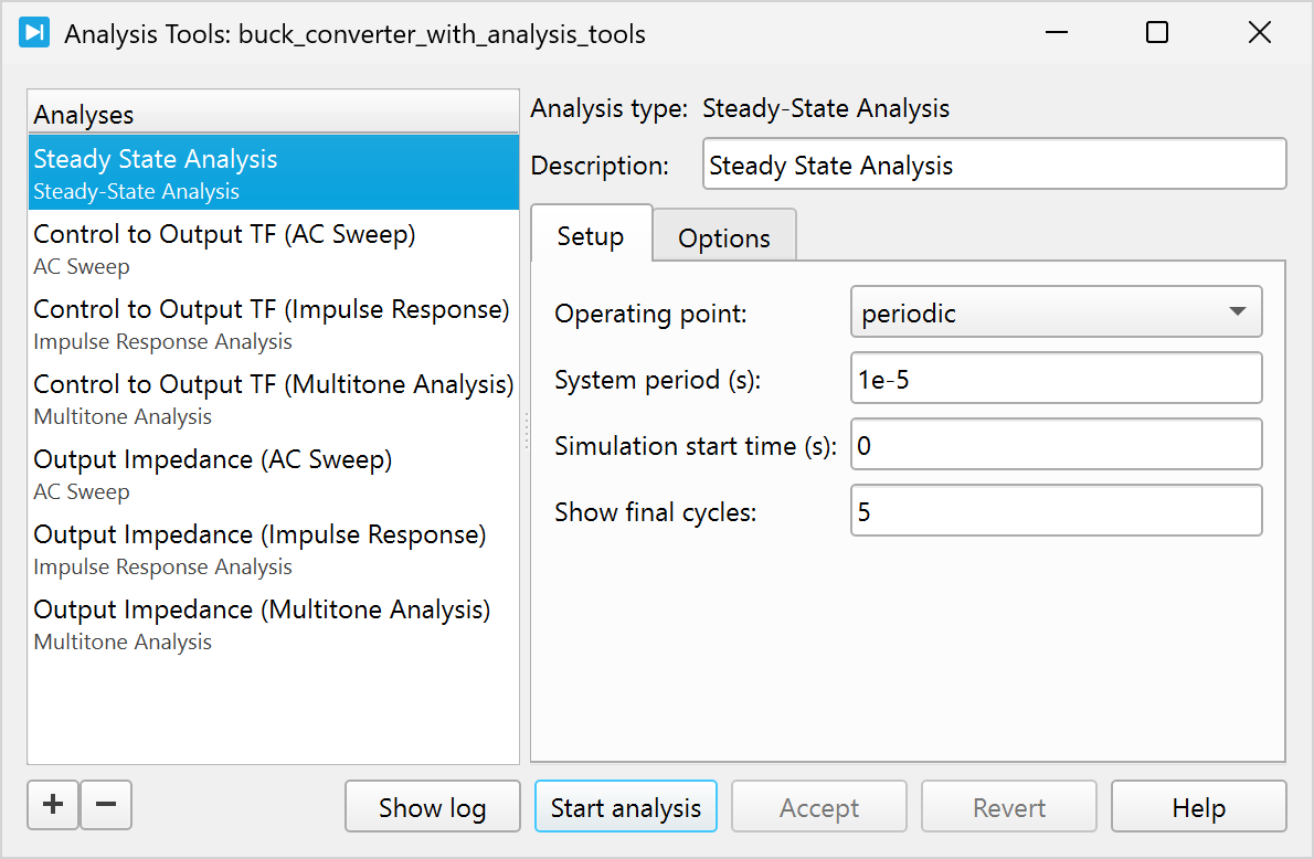

Usage in PLECS Standalone
In PLECS Standalone, all analyses are managed in the Analysis Tools Dialog shown in Fig. 91. To open the dialog, select Simulation > Analysis tools… from the menu of the schematic editor.
../../_images/analysistools.png
Fig. 91 Analysis tools dialog
The left hand side of the dialog window shows a list of the analyses that are currently configured for the model. To add a new analysis, click the button marked + below the list and select the desired analysis type. To remove the currently selected analysis, click on the button marked -. You can reorder the analyses by clicking and dragging an entry up and down in the list.
The right hand side of the dialog window shows the parameter settings of the currently selected analysis. Each analysis must have a unique Description. The other parameters available for the different analysis types are described further below.
The button Start analysis/Abort analysis starts the currently selected analysis or aborts the analysis that is currently running. The button Show log/Hide log shows or hides a log window that displays the progress of an analysis and diagnostic messages.
