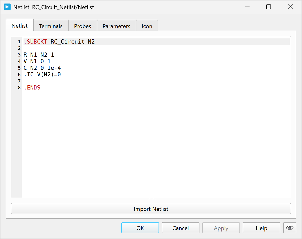

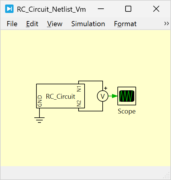

To include a SPICE model in a schematic, we use the Netlist component. It enables both writing circuit descriptions manually and importing a netlist from a file.
For example, by manually copying the netlist corresponding to the Example RC Circuit in the dialog of a netlist component, we obtain the schematic depicted in Fig. 126.
Fig. 126 Netlist description of an RC circuit
The first subcircuit located at the top of a netlist (the one defined by the first .SUBCKT and its corresponding .ENDS) is called the main subcircuit. The name of the main subcircuit is shown on the Netlist component in the schematic. Similar to a standard PLECS subsystem, a Netlist component can be resized by dragging one of its corners.
Nodes listed after the main subcircuit name in the .SUBCKT statement are exposed as terminals on the PLECS schematic. They can be used to connect SPICE models to other compatible components. To move a terminal, hold Shift and drag it along the edges of the component.

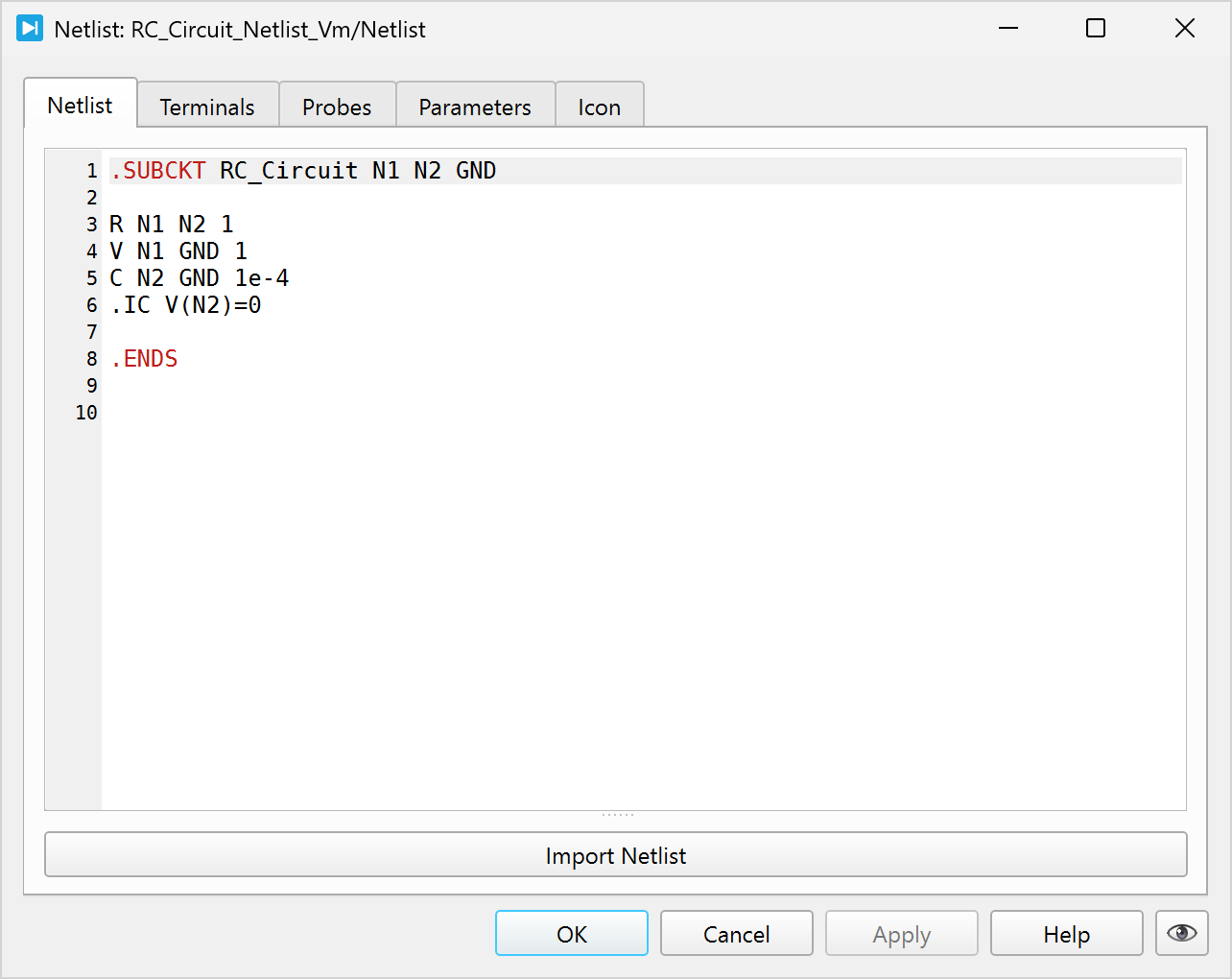

Fig. 127 Netlist with exposed terminals and ground connection
Some netlists do not reference ground (node 0) explicitly, but expose instead a terminal (often called GND) that must be grounded in the schematic using an Electrical Ground.

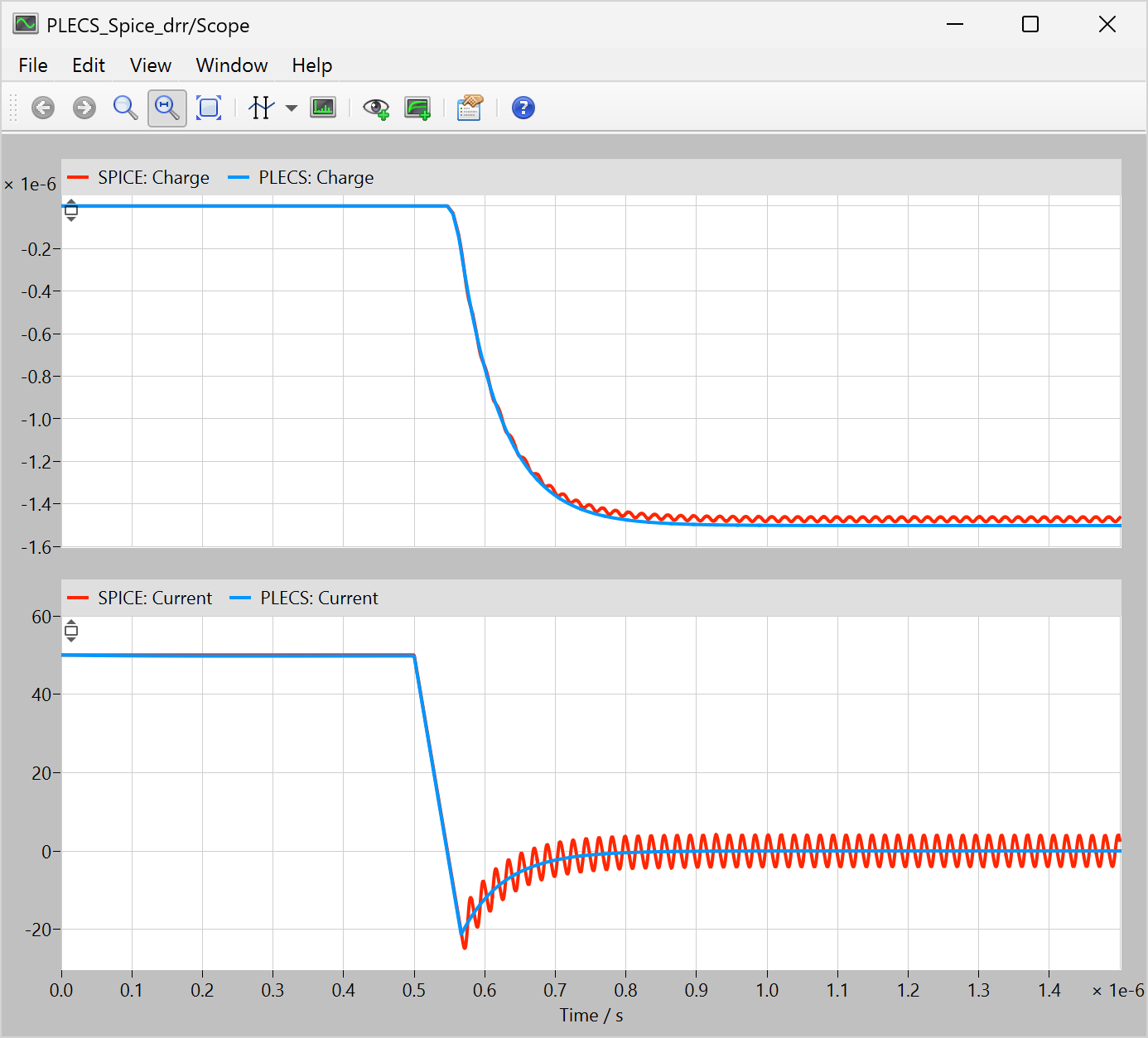

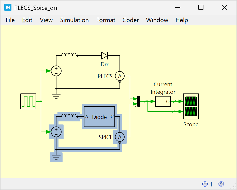

PLECS Spice solvers are capable of simulating mixed-signal hybrid schematics that contain both standard PLECS and SPICE electrical circuits.
As an example, let us study the difference between the reverse recovery of a detailed device-level SPICE diode model and that of a parametrized Diode with Reverse Recovery from the standard PLECS library.
../../_images/PLECS_Spice_drr.svg
Fig. 128 Comparison of a SPICE diode model with the standard PLECS diode with reverse recovery. The top circuit contains an ideal diode. The bottom circuit contains a SPICE model. Both circuits are driven and measured by the same standard PLECS controls.
../../_images/PLECS_Spice_drr_scope.png
Fig. 129 Scope measurements from the schematic shown in Fig. 128.
SPICE Highlighting
After running a PLECS Spice simulation, the SPICE-symbol icon appears in the bottom right corner of the schematic window. Pressing it will open the diagnostics window and highlight the electrical circuits that are solved using the Modified Nodal Analysis formulation. Parts of the schematics that are not highlighted are solved using the standard PLECS state-space formulation.
../../_images/PLECS_Spice_drr_highlighting.png
Fig. 130 Pressing the SPICE icon highlights physical models that are simulated using MNA

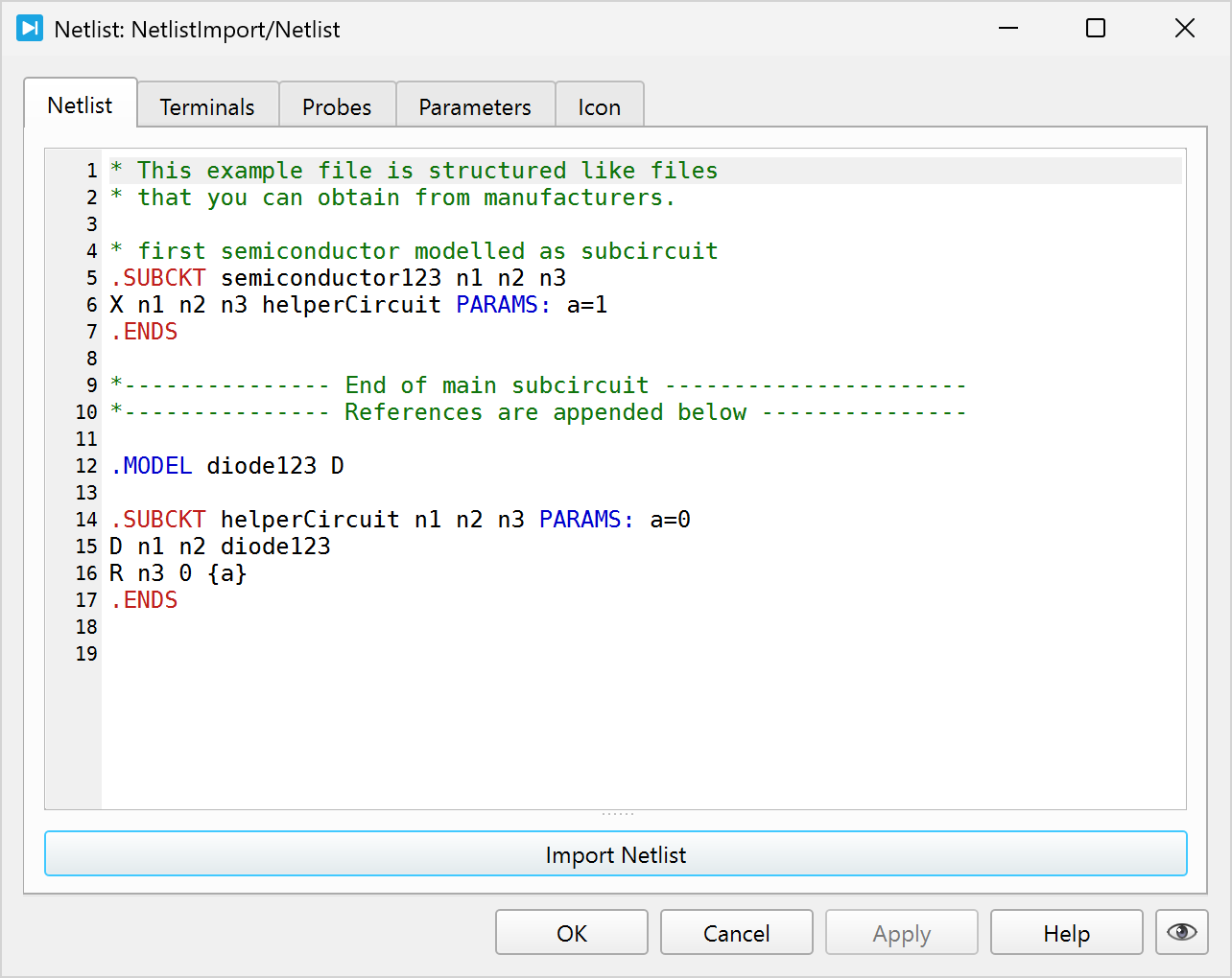

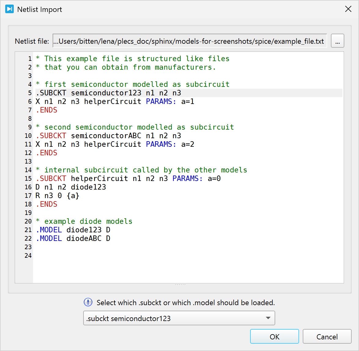

Importing Netlists
Click on the import option of the netlist component dialog to import a netlist from a file. PLECS Spice will parse the selected file and provide a drop-down menu with all available subcircuits (starting with .SUBCKT), models (starting with .MODEL) as well as the top level circuit (terminated with .END).
The importer automatically populates the text field based on your selection:
  • If you choose a subcircuit: It is copied to the top of the text field (as the main subcircuit), and all its dependencies are automatically appended.
  • If you choose a model: It is automatically wrapped within a new main subcircuit.
  • If you choose the top level circuit: It is wrapped into a subcircuit. All dependencies are automatically appended. You will have to manually list the nodes that you want to expose.
The preview window is used to fix errors occurring during the import process.
Importing a netlist will overwrite previously written/imported content.
When the dependency detection encounters errors or parametric subcircuit names, you are prompted to choose between two options:
  • Append all detected dependencies: Includes only dependencies up to the error or with the current parameterization.
  • Append entire file: Includes all content from the file, guaranteeing no dependencies are missed. This results in larger file size and slower simulation initialization.
../../_images/netlist_import_2.png
Fig. 131 A netlist import dialog with an example netlist.
../../_images/netlist_import_3.png
Fig. 132 After importing semiconductor123 in Fig. 131.

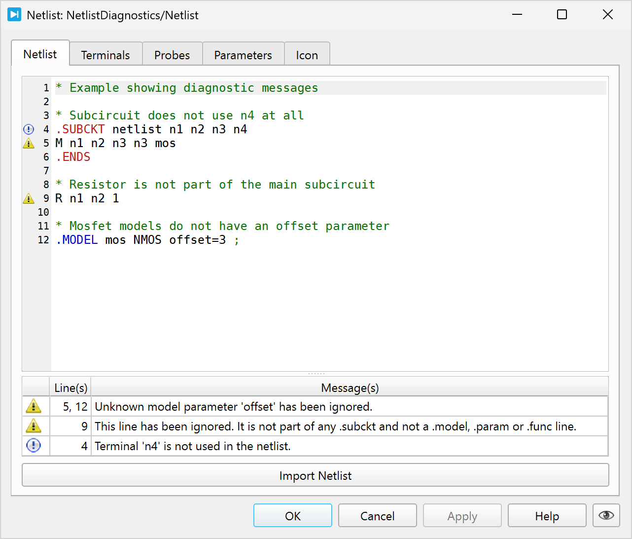

After parsing the netlist, PLECS Spice displays diagnostics for syntax violations and additional debugging information, as shown in Figure Fig. 133.
../../_images/netlistDiagnosticsExample.png
Fig. 133 Netlist showing several diagnostics.
Diagnostic messages appear in a table below the netlist editor. Click a message to navigate to the corresponding line in the text field. For messages referring to multiple lines, clicking the message repeatedly cycles through the relevant text snippets. This feature is particularly useful to debug a SPICE model or adapt the syntax of a netlist to PLECS Spice.
Messages are categorized as errors, warnings, or informational notes:
Errors must be resolved before PLECS Spice can simulate.
Warnings indicate that PLECS Spice may automatically adapt to an unsupported netlist statement (for example, by ignoring an unrecognized parameter).
Information messages provide additional context without requiring action.

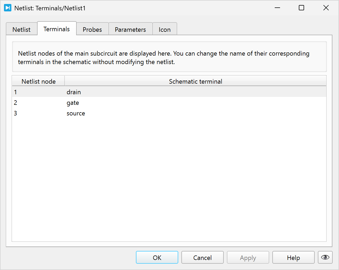

Terminals Tab

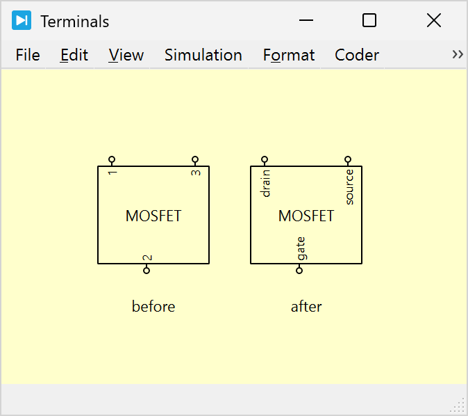

The Terminals tab allows renaming terminals of the Netlist component corresponding to exposed nodes without modifying the netlist itself. This is useful to assign standardized or meaningful names to schematic terminals.
Examples:
  • 1, 2, 3 \(\rightarrow\) drain, gate, source
  • D, G, S \(\rightarrow\) drain, gate, source
  • 1, 2, 3 \(\rightarrow\) Vin, Vout, GND
Fig. 134 Renaming netlist terminals.

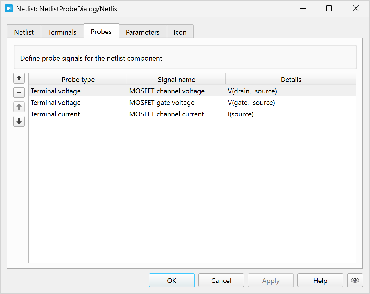

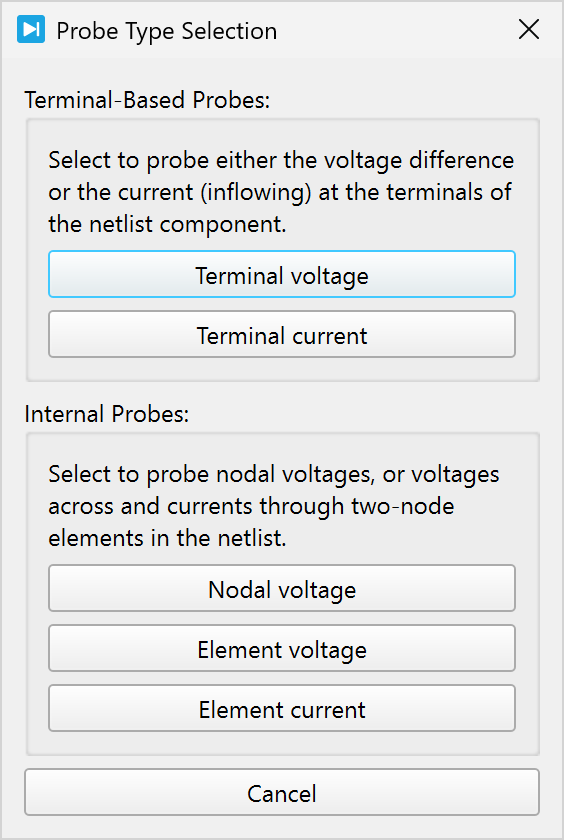

The Probes tab enables you to define probe signals for the Netlist component. These probe signals can directly be used in a Probe or in a Masked Configurable Subsystem, making it easier to switch between configurations and keeping probes valid.
We currently support five types of probes:
  • Terminal voltage probes measure the potential difference between two terminals of the Netlist component.
  • Terminal current probes measure the current flowing in through the specified terminal of the Netlist component.
  • Nodal voltage probes measure the nodal voltage at an internal node of the netlist.
  • Element voltage probes measure the potential differences across two-node elements of a netlist.
  • Element current probes measure the current in a two-node element in the netlist.
The terminal-based probes offer a selection dialog based on the terminal names in the Terminals Tab. The internal probes selection tool offers a tree view of the nodal voltages and the two-terminal elements that exist in the parsed netlist. This tree structure represents the hierarchy how subcircuits call each other.
Fig. 135 Probing netlist voltages and currents.

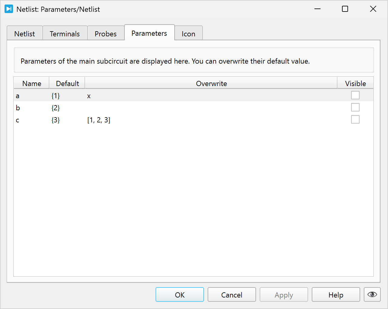

Parameters Tab
The Parameters tab allows you to overwrite the default values of optional parameters defined in the main subcircuit (specified after PARAMS: in the subcircuit declaration), e.g.
.SUBCKT netlist n1 n2 PARAMS: a=1 b=2 c=3
Overwrite values are parsed using the Octave engine. They can reference variables from your schematic’s Model Initialization Commands. This enables parameterization of device models and parameter sweeps.
The Parameters Tab also supports vectorized inputs (e.g., [1 2 3]), which vectorizes the Netlist component in the same way as standard PLECS components (see Vectorization).
Fig. 136 Overwriting netlist parameters.

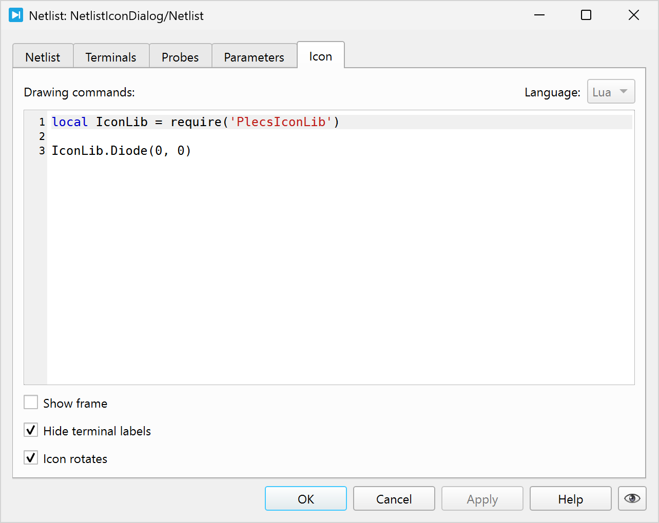

You can also define a custom icon for your netlist component via the Icon tab. As an example, let’s add an icon for the diode in Fig. 128.
../../_images/netlistIcon.png
Fig. 137 Defining a custom diode icon.
The diode icon is constructed from a triangle and three individual straight line elements and is scripted using the Lua Language. Furthermore, it is possible to display an arbitrary netlist name via the command: Icon:text("My netlist name"). A detailed description of the input dialog and the available Lua commands is available here.

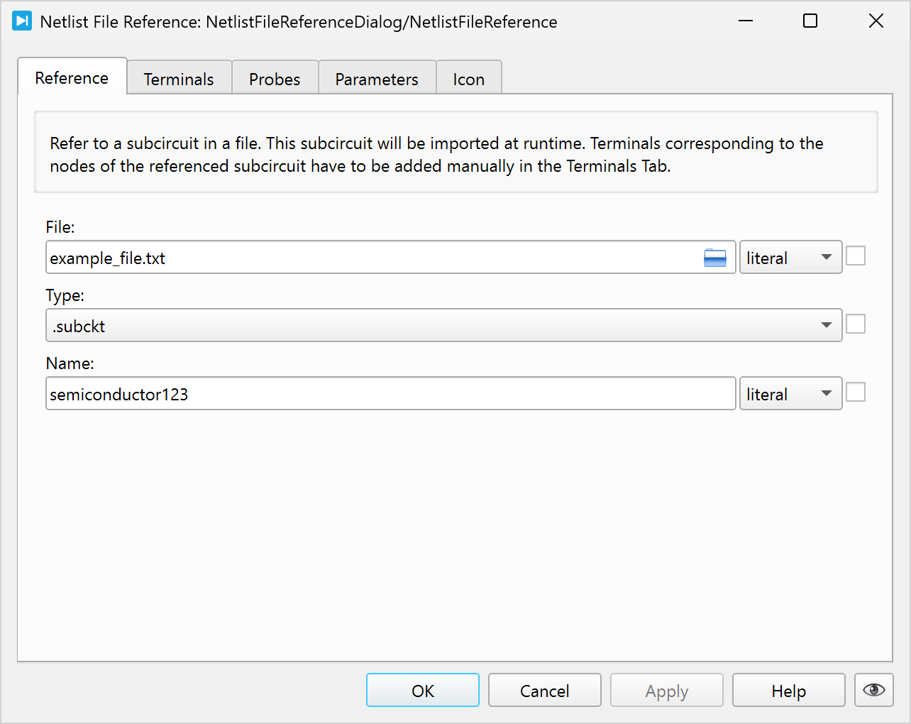

Netlist File Reference Component
The Netlist File Reference component is a variant of the Netlist component that does not store the netlist in an editor. Instead, the netlist is imported at runtime from a file.
../../_images/netlistFileReferenceDialog.png
Fig. 138 Netlist file reference setup to match the import depicted in Fig. 132.

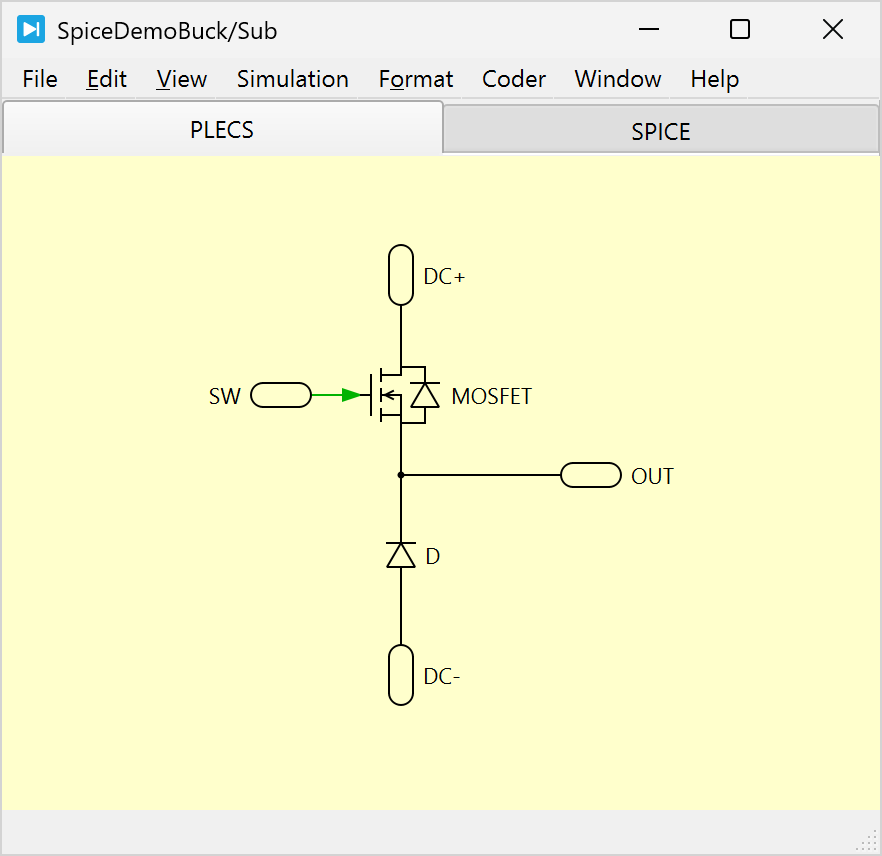

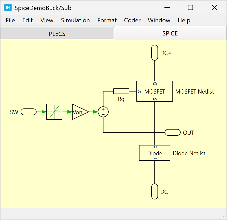

Use Configurable Subsystems
To add device-level detail using SPICE models without abandoning your existing PLECS schematic, use Configurable Subsystems to switch between PLECS and SPICE implementations of the same circuit.

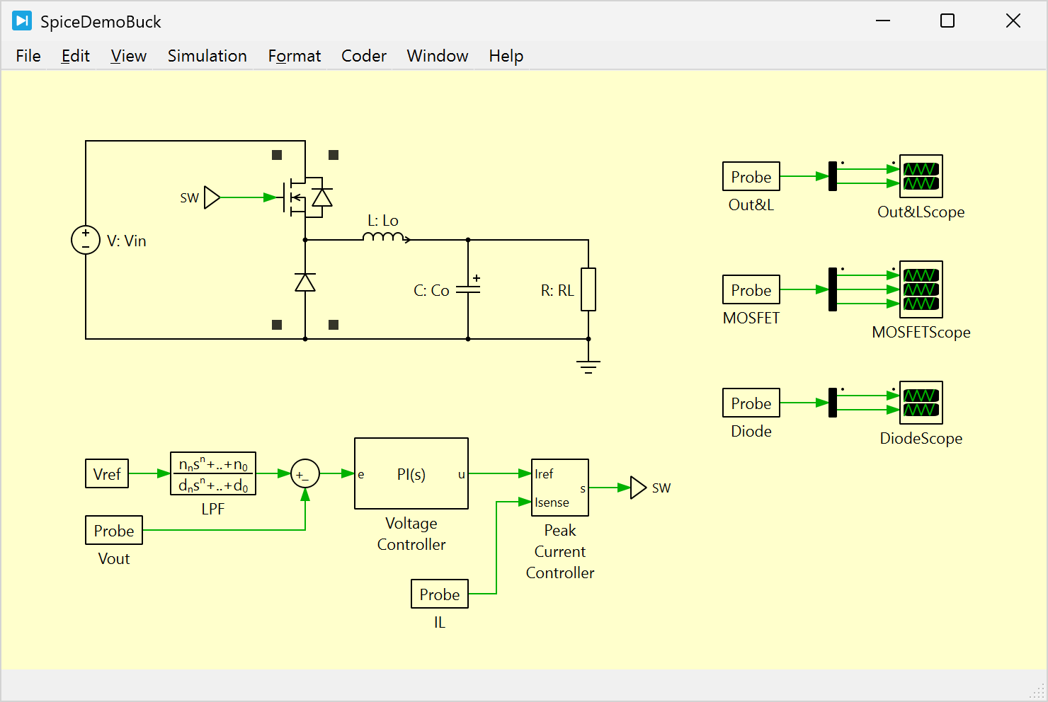

Consider a buck converter with controls in the digital domain.
../../_images/buck-schematic.png
Fig. 139 PLECS Buck converter with peak current controller
To add SPICE device models, we wrap the power stage components in a configurable subsystem with two configurations:
  1. PLECS configuration: Uses ideal PLECS components (MOSFET, diode)
  2. SPICE configuration: Uses netlist components with detailed device models
Using this configurable subsystem approach, we add the netlist components alongside the original PLECS components.
Fig. 140 Configurable subsystem for switching between PLECS and SPICE configurations.
The active configuration can be controlled directly in the schematic or through a variable defined in the initialization commands or in a script, making it easy to compare ideal and detailed simulations.

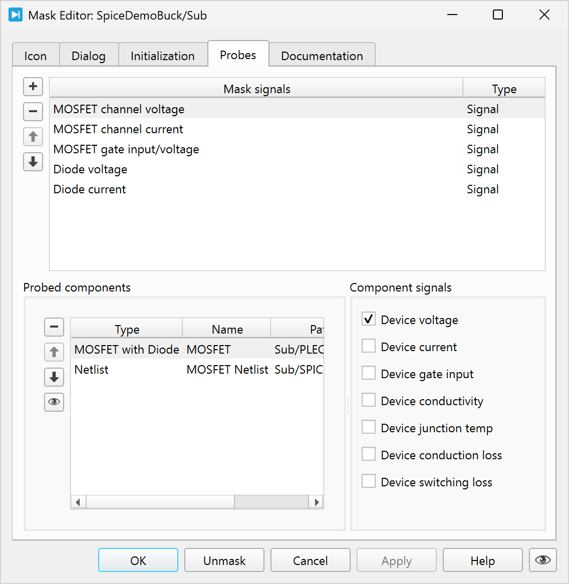

Use Masked Subsystems

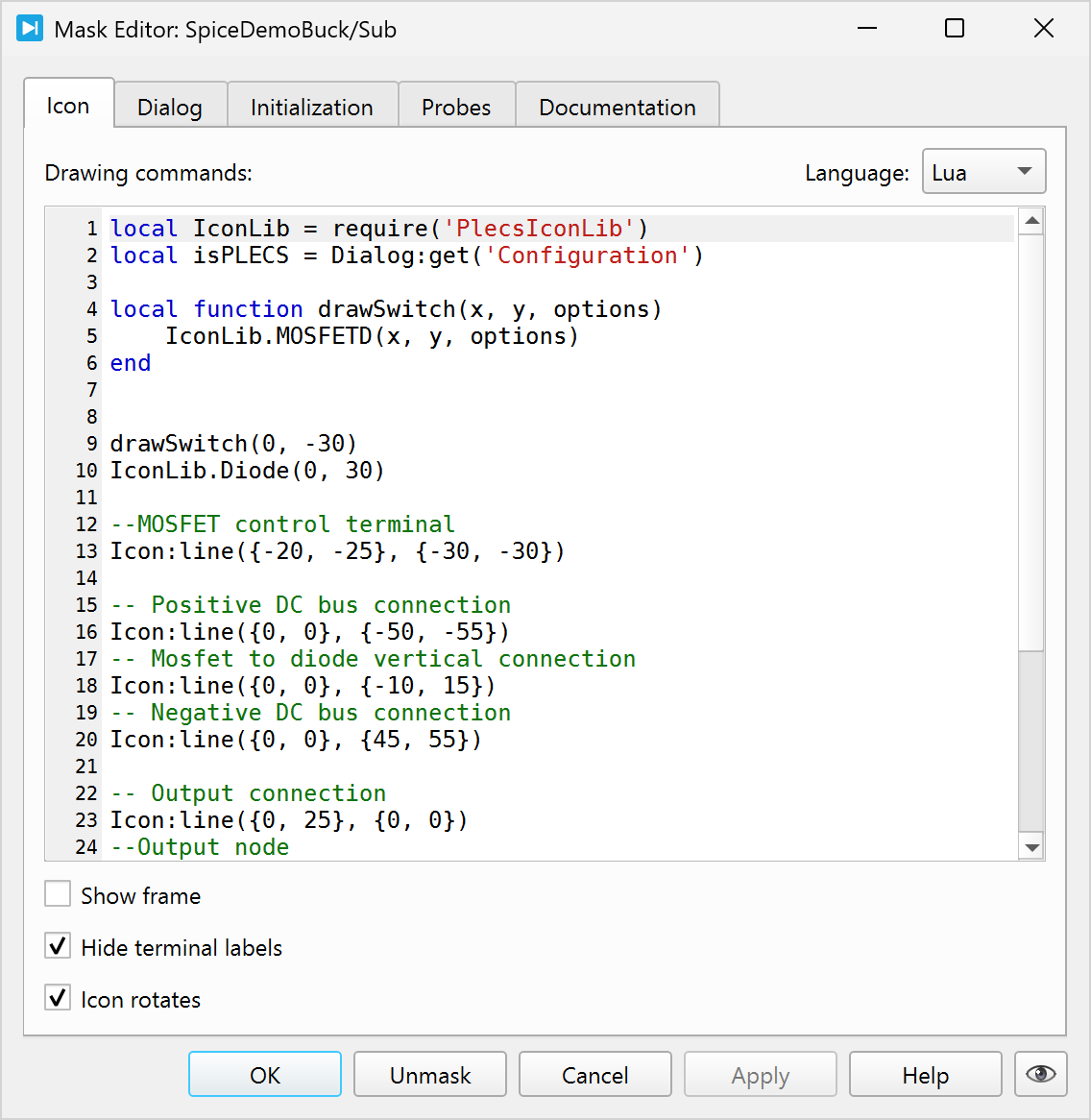

When using configurable subsystems, creating a custom mask to visually represent the devices contained in the subsystem, makes the schematic more intuitive.
../../_images/buck-schematic-masked.png
Fig. 141 A masked subsystem can be have an icon representing its contents.
In the mask editor, probe signals defined in the netlist can be accessed and used to define Mask Probe Signals. Probing the subsystem returns the MOSFET’s channel voltage from either the PLECS component or SPICE netlist, depending on the current configuration.
../../_images/buck-masked-probes.png
Fig. 142 The Probes tab of a masked subcircuit, defining Mask signals by referencing components from its configurations.

Listing 4 Calling Subcircuits
* This is the main subcircuit.
.SUBCKT main n1 n2 n3 n4 n5
.PARAM a=0
.PARAM c=3
X1 n1 n2 helper1; This creates an instance of the "helper1" subcircuit between nodes "n1", "n2".
X2 n3 0 helper1; Several instances can be created. The ground node "0" can be used here.
X3 n4 n5 helper2 PARAMS: b=4; Specifying parameters overwrites the defaults defined in the subcircuit.
* The three lines above create a total of six resistors:
* 1 Ohm between n1 n2 (R1 in X1)
* 1 Ohm between n3 and ground (R1 in X2)
* 1 Ohm between n4 and n5 (R1 in X3)
* 4 Ohm between n4 and n5 (R2 in X3) (X3 overwrites the subcircuit parameter b)
* 3 Ohm between n4 and n5 (R3 in X3)
* 10 Ohm between n4 and ground (R4 in X3)
.ENDS
* This is a helper subcircuit.
.SUBCKT helper1 local1 local2
R1 local1 local2 1
* Nodes from the main subcircuit such as "n1" cannot be accessed here.
.ENDS
* This is parameterizable helper subcircuit.
.SUBCKT helper2 n1 n2 PARAMS: a=1 b=2
* Nodes "n1" and "n2" are local and not connected to the nodes "n1", "n2" of the main subcircuit.
* Parameters, functions, and models from the calling subcircuit are also accessible here
R1 n1 n2 {a}
R2 n1 n2 {b}
R3 n1 n2 {c}; Since c is not defined here, c=3 from the subcircuit creating this instance is used.
R4 n1 0 10; The ground node "0" is the same globally.
.ENDS
For technical details on using netlists, we refer to Netlist Syntax Reference.

Parameter Sweeps (.STEP)
PLECS Spice offers two different approaches to carry out parameter sweeps:
By exposing netlist parameters in the Parameters Tab, you can sweep over them like over any other parameter in standard PLECS.
Warning
Using Vectorization for a sweep parameter multiplies the system size by the number of sweep values and can severely affect simulation speed. Therefore, it is recommended to use the scripting functionality for carrying out parameter sweeps in large simulations.

Measuring Quantities of Interest (.MEAS)
In PLECS Spice, you can directly probe voltages and currents using Voltmeters, Ammeters, and via the Probes Tab. You can use the PLECS Scope to analyze these measurements or process them via the control domain in standard PLECS.
