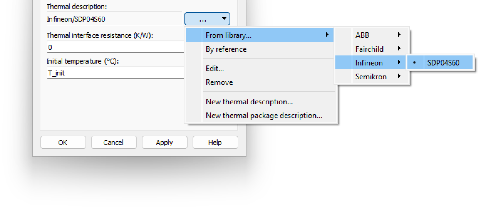

To select a data sheet from the thermal library, choose the menu entry From library…. This will open a submenu Selecting a data sheet from a thermal library that shows all data sheets that match the device type; e.g. in the dialog box of a diode only those data sheets appear that have their Type field set to Diode.
../../_images/thermalmenu.png
Fig. 62 Selecting a data sheet from a thermal library
If no data sheet is available, the menu entry is disabled. See section Thermal Library for more information on how to create new data sheets.
