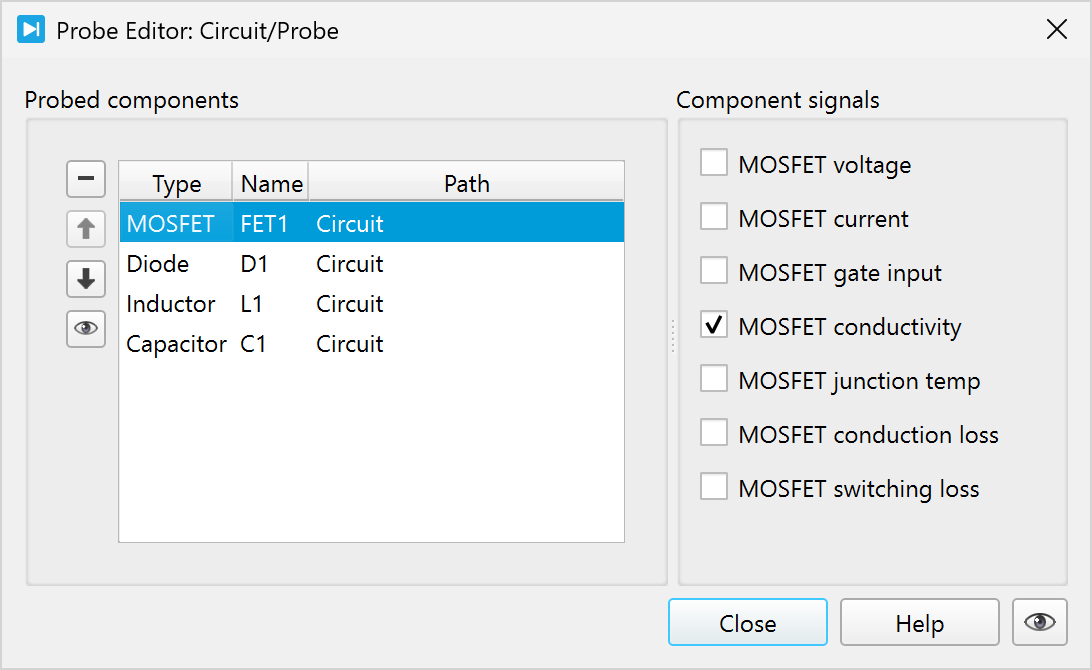

In order to use the PLECS Probe in Simulink, drag the Probe block from the PLECS library into the Simulink model that contains the circuit which you want to probe. Double-click the icon to open the probe editor window.
../../_images/probe_editor.png
Fig. 46 Probe Editor
This window contains the following information:
Probed circuit
For the Simulink Probe the text box across the top shows the name of the circuit that you are probing and its path, i.e. the Simulink system containing the Circuit block.
A Simulink Probe must be in the same Simulink model as the Circuit block whose components you want to monitor. In addition, a Simulink Probe block only accepts components from one single Circuit block at a time.
Probed components
The list box on the left side shows the components that you have selected for probing. The components are identified by their type, name and path within the circuit. For adding components to this list, simply select them in the schematic editor and drag them into the probe editor. The new components are appended at the bottom of the list. You can reorder the components using the Up img-arrow-up, Down img-arrow-down and Remove img-minus buttons. If you click on the Show component img-eye button, the currently selected component will be shown in the schematic editor.
Component signals
The list box on the right side shows the available probe signals for the selected component. Use the check boxes next to the signal names in order to enable or disable individual signals. You can simultaneously edit the signal states of several components provided that the components have the same type. In order to select multiple components, hold the Shift or Ctrl (on macOS: Cmd) key while clicking on a list entry.
For PLECS Probes that are used in a PLECS schematic there are two ways to add components to the probe: Either drag them into the Probed components area in the probe dialog (see above) or drop them onto the Probe block directly.
The output of the Probe block is a vector signal consisting of all enabled probe signals. If no probe signal is enabled, the block will output a scalar zero.
