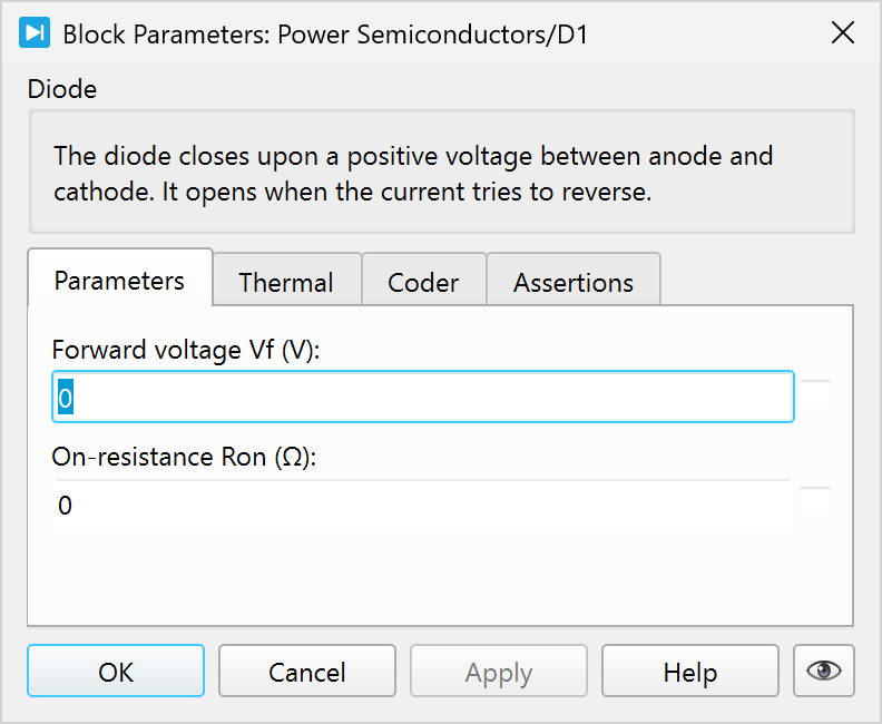

Specifying Component Parameters
Every component has a dialog box to view and modify the component parameters. To open the parameter dialog, double-click on a component or select the component and choose Parameters… from the Edit menu or the component’s context menu. You can also select the component and press the Enter key.
↳ Changed in PLECS 5.0: Added shortcut.
../../_images/diode_dialog.png
